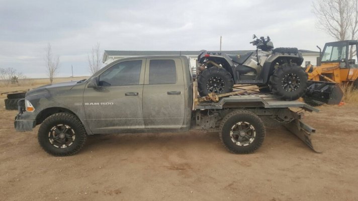

I run 315/70/17 equivalent too a 35 x 12.5 I only have a 2 inch lift in front.5630946ea46d1312918da838e3494d9e.jpg242761c750ba396818934291078582dc.jpg

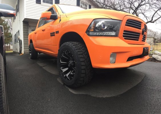

14 Sport Quad Cab with Bilstein's on all four corners - front set at 2.1
20x9 Ballistic Jester
285/65/20 Nitto Terra Grappler G2
Diameter 34.59 inches
Width 11.22 inches

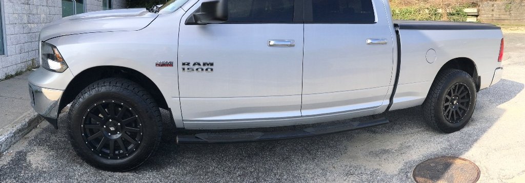

My 1500 with 34" (275/65/20LT) Nitto's. 1909d071f9c0ccd94ffe13d77a45b0b4.jpg8819d031df0d4f6a01b1a9cae29bf64d.jpg9eedf94732a82e56e0723e393b8e5611.jpg
I can't tell from the pics, but do you have a leveling kit installed? If so, what did you set it at?
BigDogg795
Sep 11, 2011
619
82
Ronkonkoma, NY
Bilstein 5100's set at 2.1". Never measured before or after so I couldn't tell you the actual difference. But I still love the stance it gave me lol.
