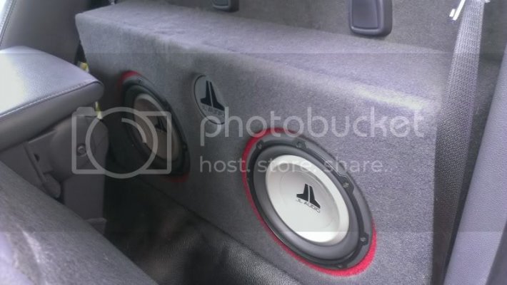

shostopper17
Feb 3, 2012
526
13
I Have 2 10 inch JL with a custom box and I have my JL amp under my seat still got plenty of room to store things, I cut the back seat storage in half so i can still store things behind my passenger seat.
Got any pictures of the cut? That was my original plan, but I'm nervous as to how the cut will look all said and done.
shostopper17
Feb 3, 2012
526
13
ill take a pic once i get some day light but its not that bad at all the sub box covers up most of the cut i did on the storage box
