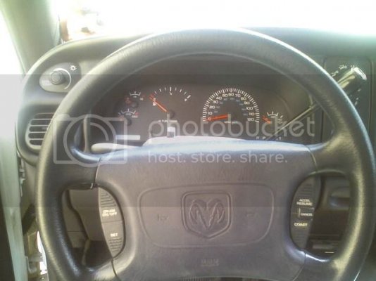

I have a 99 ram 1500 V6 Base. My cluster right now just has the big fuel gauge instead of the tachometer. Can I swap mine with one that does have the tach? Would it be just a simple plug and play or more to it?

This is what you have now correct?
