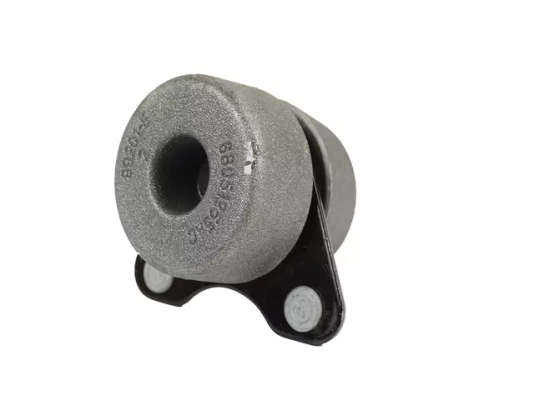

with earlier Rams, they used vibration dampers
they stopped sounds from traveling along the frame
Mass Damper - Mopar (68051255AC)​
2013-2024 Ram - 68051255ac

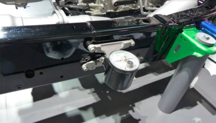

Then FCA went to this
an article about it
Much like noise-canceling headphones, these Active Tuned Mass Modules create a tiny vibration that counteracts those disharmonies, making the result as smooth as ever. They are fixed to various points on the truck’s frame, utilizing small electric motors that turn an unbalanced weight shaft. Their basic functionality is just the same as the vibration module in your phone.

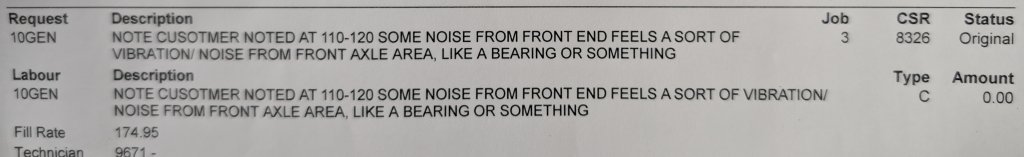

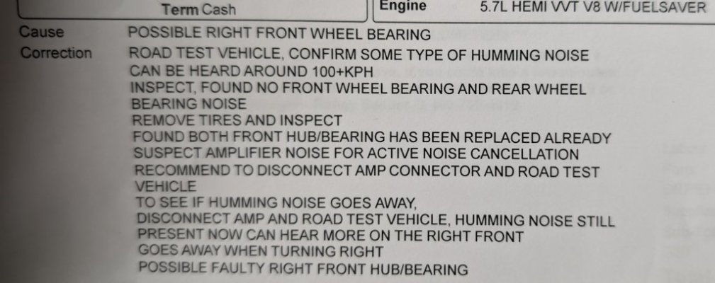

I purchased my truck last month from a Nissan dealership. They told me they put on brand-new tires (General Tires Grabber ATP) to pass a Pre-purchase inspection.
I also noticed a droning sound from the front axle when driving at 100 + kph. At first, I assumed it was caused by the brand-new tires, but I still brought it to a RAM dealership to get it checked over, amongst other things.
View the attachment for the dealer's comments to see if you recognize yourself with the same issue. Attachments 1-2 from the first visit and attachments 3-4 from the second visit.
During the inspection, the tech noticed the right side bearings were replaced by aftermarket parts. They changed them with OEM parts, but the noise continued.
Ultimately, it wasn't caused by the noise cancellation system but by the new tires. Indeed, the vibration and road noise have dropped since last month, as I am driving my truck, but they are still present.
