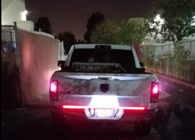

I have the OPT7 Triple led light bar installed. I installed it 2 mos ago with no error codes whatsoever. I used the curt adaptor so as not to cut/splice into factory wiring behind the tail light. I also used ceramic magnets to affix the bar to the truck. Didn’t wanna rely on the double stick tape or screw into the body. Plus the magnets allow you to remove and still access the spare tire release (not that I have a spare).

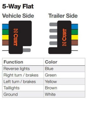

Ok thanks for the info guys. Which curt adapter did you guys use. There are two different part numbers and I’m not sure which one in use. First one is 56584 and the second is 55385. Price difference is only about $8 so it doesn’t matter which one but I want to make sure to get the correct one.
Buy the Curt 56584
It gives the five way version that allows you to use a tailgate bar with reverse lights.

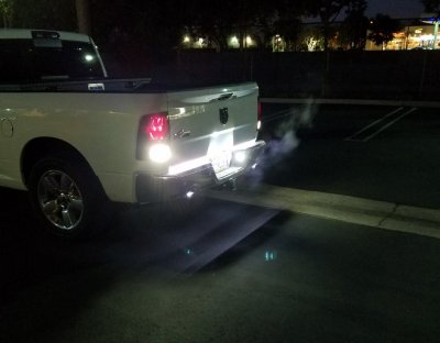

Opt-7 triple on mine with that curt adapter. Been on for a year with abosolutely NO issues. Nice n bright... reverse...
Tails..

Ok thanks. Now with that curt 5 way do I still have to tap into the tail light to get reverse? I assume not but want to double check.
Nope, reverse is one of the five wires.
You could buy a five flat trailer plug and use that to wire the tailgate LEDTowing101Chapter7.14.jpeg
Just an FYI the four and five flat trailer connection are interchangeable.

Curt is using BLUE for the reverse lights??? I gotta call foul ball on that... Color codes are there for a reason... Blue should not be used for anything but trailer brakes...
I am buying the Curt adapter so I can power extra reverse lights but am really surprised at the lack of color code protocol...
