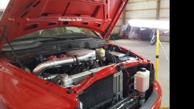

I don't go to the track often and this last year none at all. So my data is dated.. last full pass was a 11.66 and if I remember 118mph. I up the boost and and made a partial pass and ran 1.358 60'.. blew the charge pipe. Red is a street truck and doesn't have a cage so tech always watching. They actually gave me a break and told me to leave because I was using antifreeze. Heads can run up the bill considerably in the $2500+ range and IMO worth the cost. The engine is 397 Arrington stroker. My spare is an unfired 422 stroker with edelbrock heads. Obvious I'm addicted. 20190504_143404.jpg 20180617_105418.jpg

I don't go to the track often and this last year none at all. So my data is dated.. last full pass was a 11.66 and if I remember 118mph. I up the boost and and made a partial pass and ran 1.358 60'.. blew the charge pipe. Red is a street truck and doesn't have a cage so tech always watching. They actually gave me a break and told me to leave because I was using antifreeze. Heads can run up the bill considerably in the $2500+ range and IMO worth the cost. The engine is 397 Arrington stroker. My spare is an unfired 422 stroker with edelbrock heads. Obvious I'm addicted. View attachment 232072 View attachment 232073
On the 11.66 pass do you remember the boost psi you were running? And what was the 60' on that pass? Also what size torque converter? Thanks for info!
