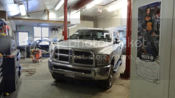

Day started off with me pulling into the lift and my tire hitting the arm and blowing. I surely was hoping at this time that the rest of the day don't continue going the same way

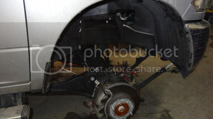

With the truck on the lift we balanced the rear on 2 jacks and removed all OEM springs, shocks, radius arms and steering stabilizer
We are about to remove radius arms,took a break to get a shot without shocks and coils

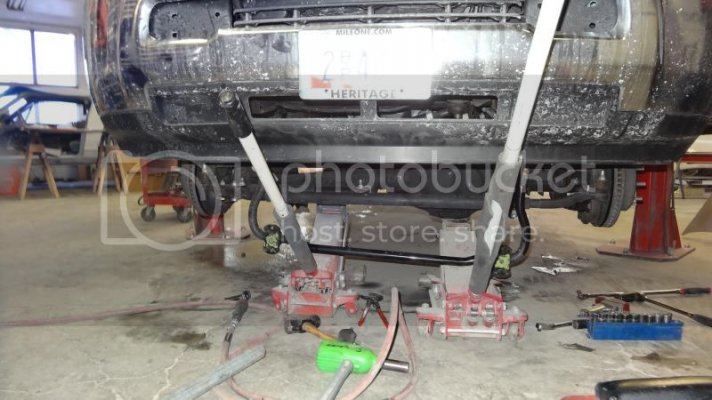

Zones radius arms, coils, swaybar relocation brackets and tracbar relocation bracket and them Fox shocks installed

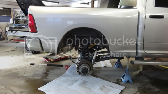

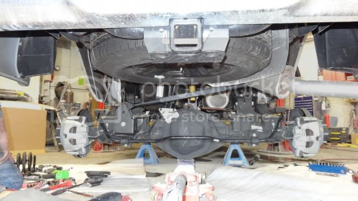

Now to the rear suspension, rear supported, coils and shocks and swaybar links removed
Fox shocks,Zone coils, swaybar links and tracbar relocation bracket installed

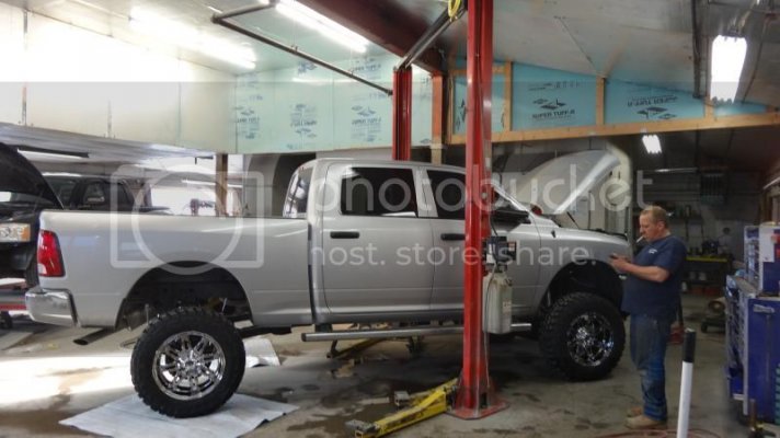

Truck coming fully together as my brother Keith takes a smoke break and the 20x10 -12 offset Fuel Hostages mounted on Federal Couragia 35x12.50x20 tires are put on the truck

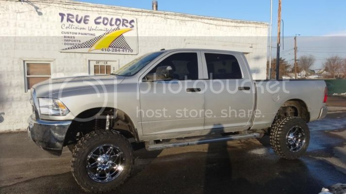

Here is truck done outside our shop in Dundalk MD

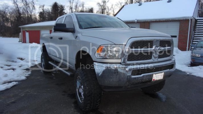

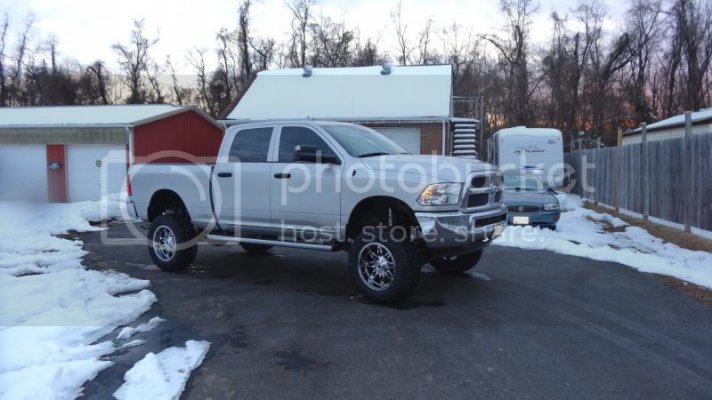

And another angle in my Mothers driveway,I am quite happy with it.
aggressive stance, tires maybe out 1 1/2 inches, nothing some Bushwackers wouldn't take care of...

First off, let me say the truck looks great. I like that your wheels aren't stuck out a mile.
I must ask though, and I've seen several others do it, why does everyone have the truck on a lift then roll around on the ground to do the rear springs? Seems to defeat the purpose. Haha

IMO we needed to be able to move the rears around a little , that being with the floor jacks we have in our shop, maybe others have different equipment but I really wouldn't want a 3/4 ton truck with 2 rears hanging around up far on a lift . To me this was the safest situation for us ..
How would you do it? And have you lifted your own truck in some other fashion? If so please share!!!!

I lowered my 2010 this week and I just used a pair of screw jacks. Same exact function and suppprt except it was chest high and super easy to work under. Either that or on lighter stuff I'll use my hydraulic transmission Jack but only having one makes it a little rougher to move each side individually.

We have a Bodyshop and our main focus is to fix wrecks,so we don't have the set-up that a full blown mechanical shop has,plus we have a very low ceiling which don't allow for us to put truck up all the high...My knees do hurt tonite and surely will be worst tomorrow,but I'll just take a peek out my door and look at that truck and they'll feel better!!!!

It gets the job done, that's what it's all about. I feel you on the low ceilings, mine are right at 12' so I have to close all my hoods or risk sending it to a guy like you when I crush one. Haha
