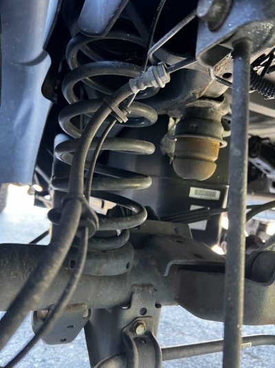

I bought this truck used and I want to go a bit higher, but I can’t figure out how much lift there currently is on it. It does have Bilstein 5100’s in the front but it doesn’t sit level. It’s 40” floor to wheel well in front and about 42” in the rear. It’s on BFG KO2’s 315/70R17 which are 34.4 diameter. I know what lift blocks look like on leaf springs, but with coils in the back I’m clueless.
Any ideas? Given that there are already Bilsteins on the front, what would be my easiest / least expensive way to get 2 or 3 more inches of lift. I am fine with keeping the rake or going level either one.

The bils dont look to be adjusted up all the way, so you could possibly adjust for more lift up front. For the rear, look for a coil spacer on top of the coils (obviously isnt one on the bottom side). And look for a mopar tag on the coils, which would indicate they are the factory springs.

You have adjustable struts up front…no need to go with strut spacers, which are highly not recommended anyway. As i stated, count the rings under the coil cup…you may have adjustment for more lift with them. All you would need aside from doing that is upper a-arms.
And yes..:you dont want to go much more than 2-3” with stock suspension orientation. Anymore than that and you will wanna drop the front diff with brackets from a 4+” kit.
