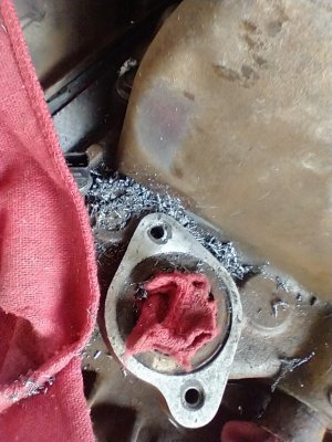

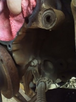

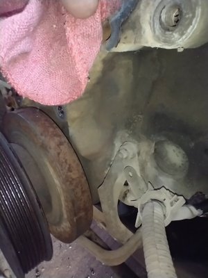

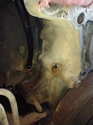

Here are some pictures I took real quick. Now the wet you see is most likely Marvin Mystery oil I'm sure. Now whats behind is a mystery in its self. I'm a little confused why a V6 tensioner would become apart of this change? Its a 5.2 motor. Take a look and tell me what you think. I also show a picture of broken bolt in intake manifold. That I am done with trying to remove so I'm going to pay someone else to deal with. lol

Sirriggs, the 3.9 is the same as the 5.2 just with 2 less cylinders. Same design, bore and stroke. Basically a sawed off 5.2 the 5.9 is the same layout as well just different bore and stroke. Also the 5.9 is balanced different. They have the same Water pump, timing cover, accessory drive, and timing chain.

To remove that bolt put a.washer above it and weld it to the bolt with a mig welder. Then weld a nut to the washer. The heat will help loosen it and the nut will give you something to get a wrench on.

I may just put the timing chain on hold for now so I can get it back up and running as soon as possible and to save some cash up. Anyway. The bolt is broke about a 1/8 down. What you see is JB Weld. I was told to fill it then drill down since the bolt broke of on a bad angle. Well it didn't seem to want to work and I don't want to push it either with a hand drill. My small drill press wont allow me to access it. I don't have a welder either so I will let someone else who has the right tools do it. Found out the intake kit will be here by Friday so I'm going to pull the intake to get it down so hopefully get it back by then. If not, then I will have to wait but at least I can get everything ready by the time I get it back.

Well another episode of how your stomach turns. I did manage to get the hole drilled out and didn't really oversize it but now here is the catch. Being its so close the the Keg/Intake. I cant find a way to thread it for a bolt. I will attach a picture. I looked down into the intake and its extremely clean which means I might hold on to the kit I bought from Hughes for maybe down the road if needed but Yes but That may change if I have to remove the intake to have someone thread it for me? The tap i found is 5/16- 18. I will post a picture of it as well. Is there a way to find deep threading tool? It just seems something always stop me for a short time. Im going to search online to see if I can find anything but will check back and see if any of you might have a way to solve this issue. lol Thanks
