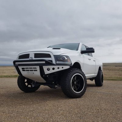

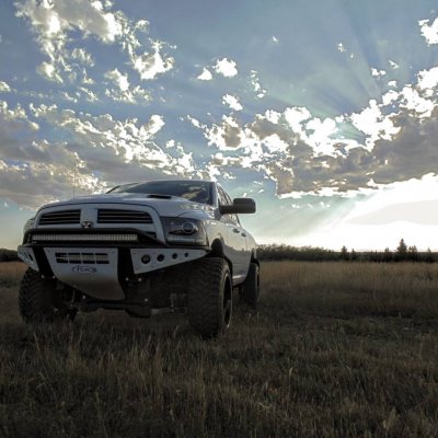

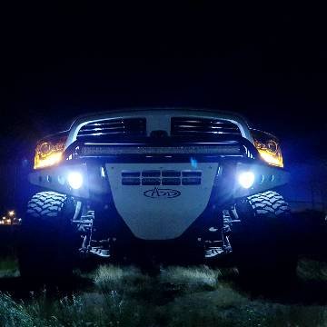

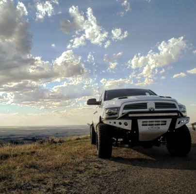

Hey guys and gals. New to this forum specifically. Looking for a bit of help. Quick mod list before i get started
2014 ram 1500 5.7 sport
4" zone lift
Ride rite coil air bags in rear
20x12 visions
Whitebear fabrication kickbacks
35x12.5x20
ADD stealth front bumper
Airaid t/b spacer
Afe intake
Diablo t1000
Jones flowpack muffler
MANY led's and lights

Can't help with the rattle, but that is one nice bumper!
