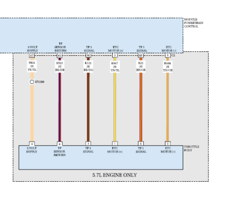

If after the above mentioned operations, you still have the Service ETC message and are still in limp mode, you can disconnect each end of the harness and check continuity across each wire to verify their integrity.
It's not a complicated circuit to test. One end of the harness is at the throttle body and the other end @ the PCM. The appropriate connectors/pins are mentioned in the service manual. My book is for a 2013, if you need a diagram specific to your truck, AllData DIY is an option.
If the wiring ****** good, then you've narrowed it down to a bad throttle body or a bad PCM. The throttle body is alot cheaper, so id probably replace that one first.
