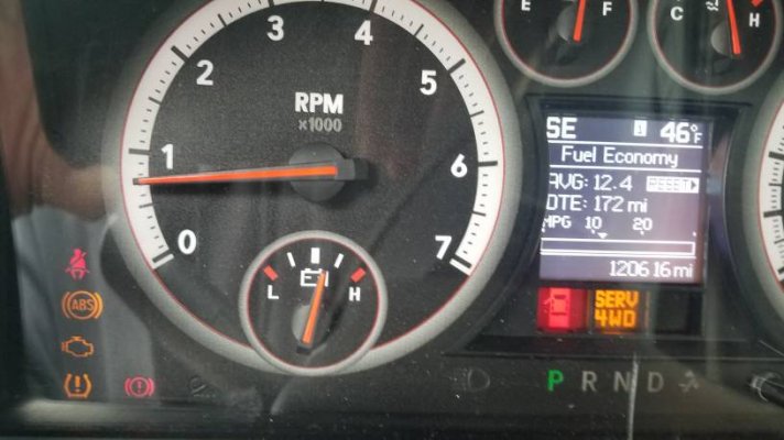

I just picked my 2012 up from the dealer I bought it from after they replaced the tipm. As I was driving it home, I noticed that the windshield wipers and electric seats weren't working. Once home, I opened the hood and the tipm looks as if it came out of a used or junked truck. While checking the fuses, I found that those 2 relays (seats and wipers) were not installed but some options that I dont have, had relays. I moved the relays to the correct location and now all service lights are back on. I'm taking the truck back tomorrow for them to fix it correctly. a3eab2b6a504cb2cafda3bd68c03fb6a.jpg
