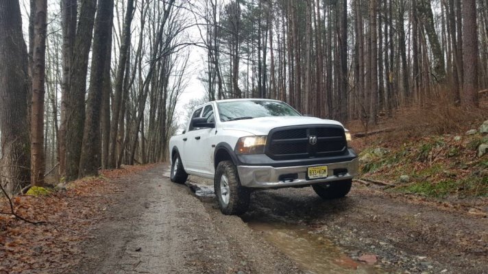

Hey y’all thinking of leveling with bilstien 5100s set at 2.8 with a 1.5 inch rear spacer and tuftruck 1211s. Also adding UCAs wether mevo or zone not to sure yet...anyway looking to run 17x9 rims with 0 offset. You guys think 315x70r17s would rub with this setup considering no negative offset on this rim? Anyone running something similar?

Should be fine ... Check customoffset.com for more info and pics

Running a similar setup with 1.5 wheel spacers which effectively put a me around -12 offset and I have no rubbing on 315s4fcb95c208966e29b26677810b6608d7.jpg
