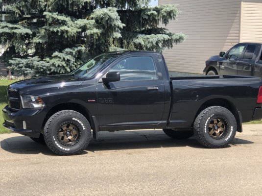

After lurking in here for awhile and getting some great, albeit expensive ideas I figured I better contribute.
Just installed my thuren stage 2 king shock setup I got for a crazy good deal from Neil at maple off road in Sask Canada as he had someone back out on him and it happened to be exactly what I was looking for. Fortunate for me as I had no wait time ( not super patient ) and they weren’t to far from me.
I’ll be going to see Neil for some custom bumpers shortly after looking at his work on 2500/3500 rams he specializes in.
After running the bilstien set up up front and stock shocks rear for about a month,
I quickly realized while this set up is fine for most highways ( except most around here y’all would have to see to believe the confusion s of the roads in this province)
But I spend a good deal of time on dirt roads for work and for general travel I wanted something more.
After a fair amount of research I decided on my current setup thuren kings stage two as I encounter a lot of smaller bumps than big whoops and I chose the zone ucas because they use the standard ball joints if I was to go with a univalve type upper it would be kibbetech hands down, rims are 17x9 fuel podiums and tires are general grabber atx 35x12.50x17 I have zero rubbing issues with kings set at 2”. I wanted to keep the setup strong and simple as I’m planning on using this vehicle for overland adventuring.
To this setup I’ll be adding core 4x4 rear control arms, stabilizer links and adjustable panhard bar.
More of the outfitting of the truck for travel as it progresses.
I have only driven a couple of hundred kms on dirt but the improvement is more than I could have hoped for. So much more control over washboard and they potholes, actually a very Odd sensation traveling over the same roads as I did previously and the truck hardly seems to move, you hear the suspension working and the impact of the bumps but you don’t feel them and the truck stays arrow straight. The harder I push the better it works. Well worth what I spent I feel and there is just no comparison to the Bilstiens.
I recently got rid of my 2018 raptor and so far I feel this setup I have is actually better just not sure it would handle airtime as well as the raptor did giving up roughly 4” of suspension travel.2ede7c71ae9343aff9c76aa8bfe501bd.jpgo2ede7c71ae9343aff9c76aa8bfe501bd.jpg

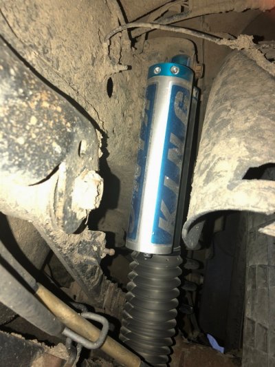

eea7d16b210547bd1bfceb9410139d22.jpg9fb185bdc8a782a413efeb9c7d7a3587.jpg5e59baf68d976ffe85a2c4e23135cd2f.jpg1d855b3382e7e6d39afc3aeb687052c8.jpg

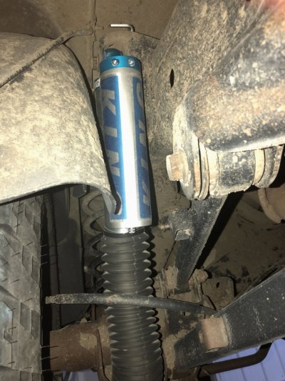

Ps, get some heater hose and wrap that resi tube up. @ram1500rsm has kings and zones and had the hose resting on the uca in the same spot. Don't wanna blow that line when you're getting jiggy with it

Thanks for the compliments and the tip on the heater hose was just looking at that today

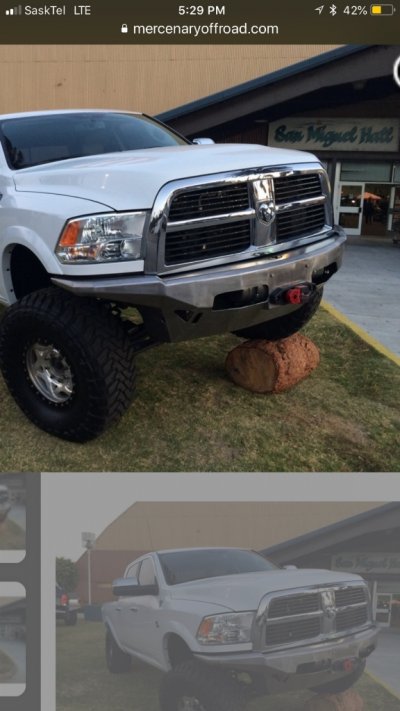

For bumper thinking something along these lines not exact but similar
For the front
And a duplicate of Maple Off Roads tear that he does for the 2500/3500bd3d3547fd08e4fe72fefa43d1fa005b.jpg

I see you're now in the bumper selection post some pics if you end up going aftermarket. You'll need to crank of the CO's to keep the same height you have now since most aftermarket bumpers will be heavier than stock.
Check my built thread i have some tips that will show how to adjust them the easy way. it takes me about 30 minutes to do both sides now that i have the practice.
I'm at 11 open threads in the driver side and 10 in the passenger with an ICI throphy bumper which is prob one of the lighter tube bumpers out there, and i have accomodated 37x12.5x17 KO2 tires that way 100% offroad functional too with just 2.5-2.75" lift without having to cut anything, minor fender lip adjusting in the front though. One day i'm expecting this ****** to be my full fun offroad toy and that will including jumps too :) for now is a DD with weekend fun duties.

I was considering the ici Baja if I go off the shelf bumpers strongly, doesn’t seem like u can beat them for the price.

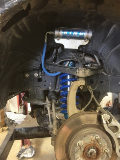

My Fox 2.5’s had the different holes to mount then reservoir bracket. I tried the center one first and it only left 1/2” or so of clearance between the control arm and the hose. Moved it to the back one (which isn’t much further and I now had plenty of clearance. I wish I took a pic of the Fox bracket to show how they do theirs.
Maybe drill a hole in the bracket to give more room for the hose. That way you could get ditch the hose protector??
