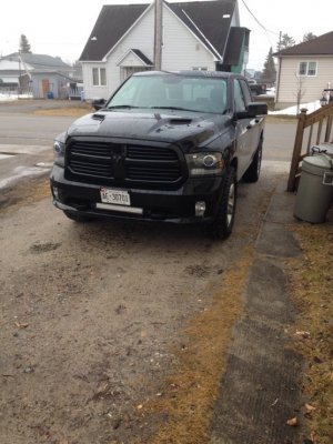

This is what -12 will look like. If I could do it over I'd go for a wider stance. I have the factory flares as well
