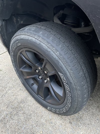

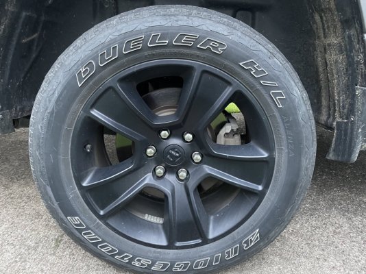

Add a picture so we can see what factory wheels you have. You’ll easily clear a 35” but the width is going to be the variable

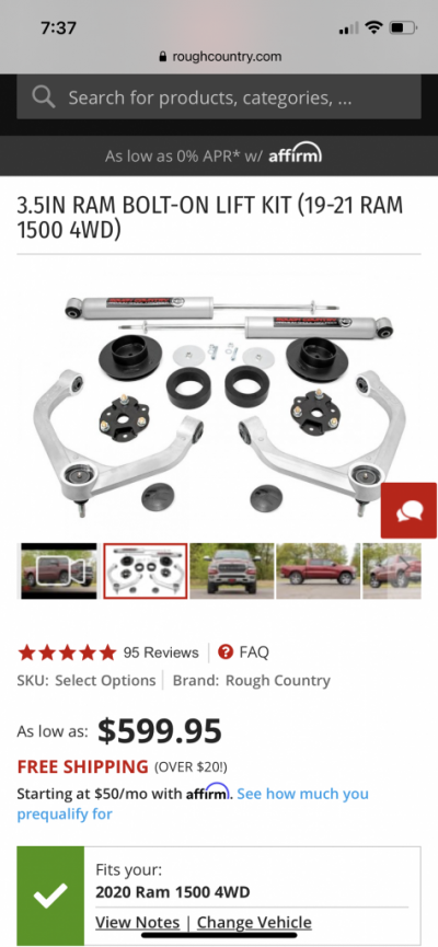

Here are a couple pictures of the factory wheels and the lift that was installed. Stock tire size is 275/55R20.

Are you just looking to go with the stuffed tire look? I ask because you are asking to fit the biggest tire? A 37” tire will fit as many have proved so I’m just trying to narrow down. My guy is telling me that you’re looking for a 295/65

I’m looking to go up in size to fill the space. I hate the size of the stock tires since I got the lift. Was thinking a 285/65 or the 275/65 will they fit?
Yes both of those sizes will fit easily
