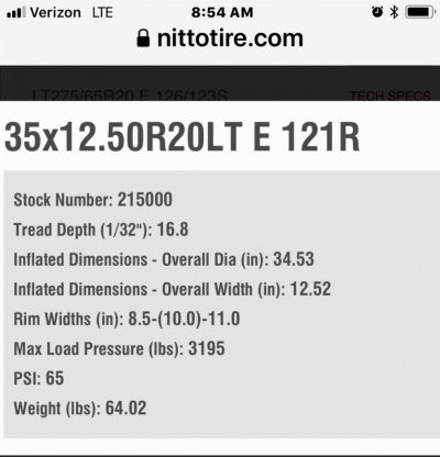

The other negative with increasing the actual size of tire, say from 17" to 20" or whatever, you seem to lose in tire load rating.
I disagree with loosing load rating. You can actually go up in rating with the correct tire by manufacturer. I’m yawing a 35-12.5/20 Nitto Terra Grappler G2 weight rating is 3195# E rated 10ply

I went with the Terra Grappler G2’s as well, 37” with 65psi max and E rated sidewall. Put 2100# in the bed and they don’t look stressed at all.
