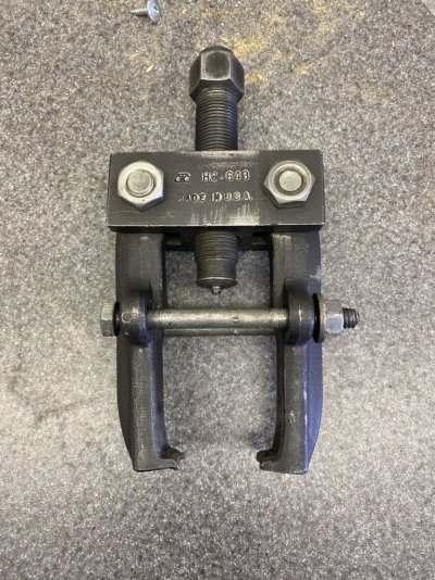

theres a heavy duty puller your suppose to use. cant remember the part#. the otc site might say which one

Works every time...
