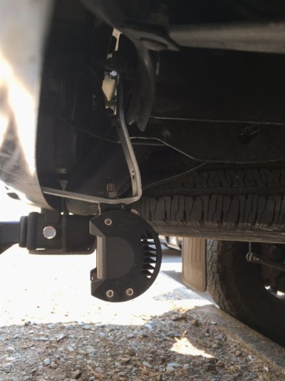

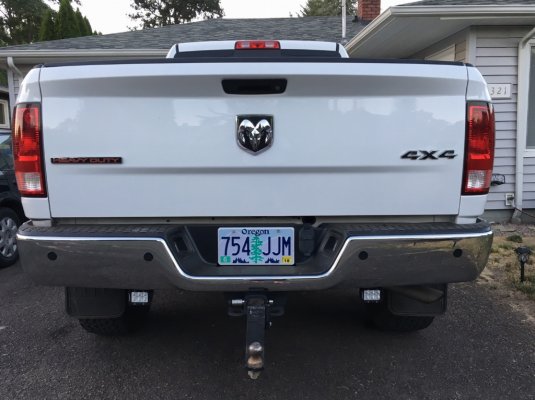

This is my setup. Just some pods I got on Amazon with good reviews. Tapped into my reverse lights. Mounted them with a 5x5 L bracket, they sit flush with the bottom of the bumper. Have been great for about a year now, and it was inexpensive.
I like you version of the install. Where did you mount the bracket? Since the other end of the bracket sits on top of the bumper does it rattle or allow water to get stuck there? I am wondering for rust reasons.

Mounted the top of the bracket to an existing hole in the tow hitch. And the bracket is very rigid. Doesn't budge at all. Had to put it in a vise to get the slight bend I needed

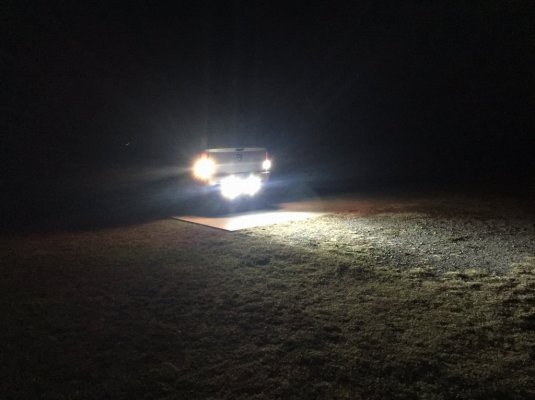

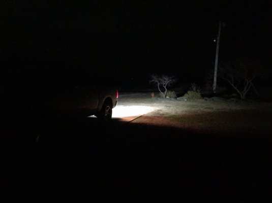

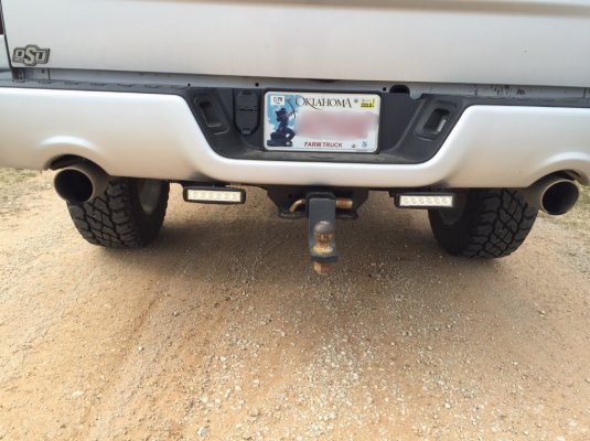

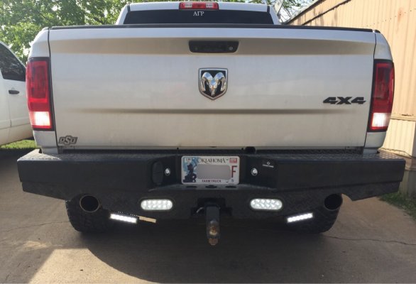

Yeah those are way overpriced for what you get IMO. I got these off Amazon for $19 and they are awesome. I mounted them to the stock rear bumper by simply drilling through the bottom lip and using the bolts that came with the lights. Tapped them into the reverse wire in the trailer wiring harness. I've since upgraded to the Ranch Hand rear bumper and have the oval LED's that came with it tapped into the trailer wiring harness and the LED pods from Amazon wired to a switch. Amazing light output...
Mounted to the stock bumper:
Below are nighttime pics with the stock bumper setup. There's even more light output now with the addition of the oval LED's on the Ranch Hand but I don't have any nighttime pics (yet) of the new setup...

the only problem I see with those is if you tow they are in the way of where you hook the chain on. you will be able to hook it but the chain will be dangling on the lights and bracket.
Below are nighttime pics with the stock bumper setup. There's even more light output now with the addition of the oval LED's on the Ranch Hand but don't I have any nighttime pics (yet) of the new setup...
These are the same lights I have that I will be installing in a similar position but just slightly wider. Great night shots, thanks for posting.
