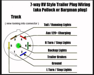

Any chance you can elaborate more on how you did the wiring? Ive been wanting to do this for a while but am hesitant to start cutting into wires. My luck ill fry everything. Pics help alot also if you have them.

You can just get the reverse power from the back of the trailer connector. You can also get the ground from the same connector or simply ground it to the chassis. The trailer wiring isn't canbus monitored so you can do what you want.
Or if you don't want to tap into your factory harness you can use the curt harness and tap off of that
https://assets.curtmfg.com/masterlibrary/56584/installsheet/CME_56584_INS.PDF
https://www.curtmfg.com/part/56584

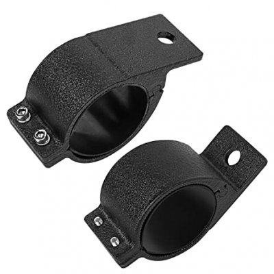

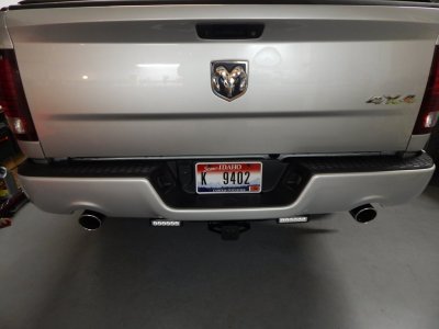

I used "roll bar" clamps on the Curt class IV hitch, and a lower profile LED from superbrightled. I ran a separate wire to the front where it is switched independently. I have installed rear work lights on all of my other trucks, but the 4th Sport was more of a challenge to make it low profile and clean looking.

I would like to see what "roll bar" clamps look like. I am pretty familiar with fasteners,but have never heard of "roll bar" clamps.
Can you show me what a "roll bar" clamp looks like? I am pretty familiar with fasteners but have never heard of a "roll bar" clamp.

From a 12v technician, great work! I did some flush mount rigid srq in my back bumper but I never thought of that location. Looks really good

Thanks I appreciate that, it really is a great location

Here is what my roll bar clamps look like, and I got them from Amazon. This fit perfect around my Class 4 hitch.
AKD Part 2pcs 2.5 inch LED Light Bar Mounting Bracket Clip Universal Clamp Kits Tube Clamp Roof Roll Cage Holder LED HID Work Light
