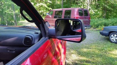

I bought mine from 1Aauto. They are exactly like the factory ones on my 2003 and they plugged right into the factory harness for heat and power adjustment.
Ordered the ones for 99 Ram 2500 and installed them by myself in about 45 mins.
Been on the truck for a few years and look in better shape than my 03 and my 15.
Look much better and are great both extended for towing and regular around town. The blind spot is very helpful also.
Make sure the one you get has the reinforcement plate.
I think for both it was 179 on sale.
