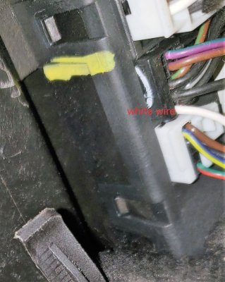

I installed a set from a 2012 into my 19 classic. (Dealer said cant be done) Anyway I did it. Took Temp sensor out of my OEM Mirror and put in tow mirror( drilled a hole next to puddle light) for sensor tip to stick out. First, disconnect battery.Then remove sensor cover from original mirror and cut wires a couple inches back from plug as you will have to add extra wire for hook up. Install tow mirrors and stick sensor in from from inside of door. drill hole in arm so sensor tip sticks out. The black plug on tow mirrors is where you will be tapping into. Add about 18 inches to wires. White wire will go into bottom left hole on plug and black taps into black( this is the two that are together). This is the tricky part. you will only want to make a slice into one wire cover so that you can tap into. Re connect battery and start truck. wait for temp reading. To verify proper wire, turn on heated mirror. If temp reading stays the same your good to go. If it starts dropping colder then you have to tap into the other black wire( yep confusing). Temperature ground and heat ground share same plug terminal. Its the resistance that's different. No need to have it flashed unless you want puddle lights working. 2018 and up has to be dealer because of Secure Gateway Module. (SGM).
