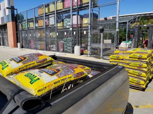

25 bags of mulch, about 800lbs total with some other stuff I had in there.
The power was fine, hardly noticed anything being back there. However the suspension was bottoming out when I went over speed bumps and out driveways. I took it as slow as I could.
Should I be worried about the suspension bottoming out? Think I need to replace my old 14yr old suspension parts?

2 ideas...maybe 3
1. Move the load fwd in the bed.
2. Remove 1500 badges & replace w/ 2500 badges :)
If neither works, yeah, you might very well need springs & shocks. You shouldn't have bottomed out hitting a speed bump.

Thanks for the reply.
1. The load was as forward as it could get, the tool box blocked it from going all the way against the cab
2. If I do this will I also get 2500 fuel economy?
I'm thinking it's time for an upgrade on suspension anyway

The only part that holds the truck up (in the rear) are the springs. Look at replacing those and the bushings.
