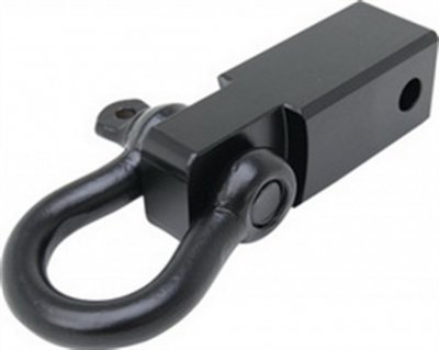

While no this exact brand, I use something like this in my hitch.
https://www.amazon.com/Smittybilt-29312B-Receiver-Shackle-Receivers/dp/B001CF1A7O
Before I bought the shackle arrangement above, I used a shackle with an extra hitch mount. Works the same. Agree with no using the hitch ball and please don't use straps with metal hooks. If you've never witnessed a strap break and a hook go flying through a windshield, it is an eye opening experience!!!

TRCM talked me into buying one of these instead of using the safety hook locations. Haven't had a problem yet, but this might fit in one of the floor storage bins so I can carry it with my straps. My pintle hitch I like to use is just too big to keep in the truck all the time so it sits in the garage unless I need to pull the trailer.
