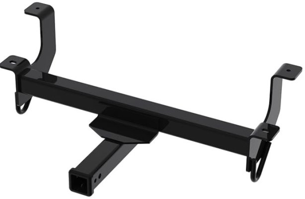

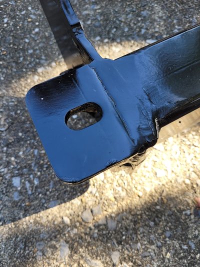

Was looking for a means to get a front hitch to allow putting bikes up front, tow a teardrop trailer, keep the tonneau closed for weather protected storage, still be able to use my rambox, put a canoe on the cab and finally - keep the factory tow hooks. For the 1500 model I have, the tow hooks need to be removed to mount aftermarket front hitches unless you do a modication. Rather than a complete fab I ended up modifying a standard front mounted hitch Reese 65062. I purchased the hitch new in sep-24 and it was $186, for some ridiculus reason I now (2 months later) it is $220. The Reese hitch is already setup to mount in front but the tow hooks need to be removed for the original fit, didn't really like that idea.

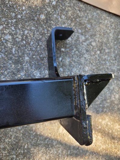

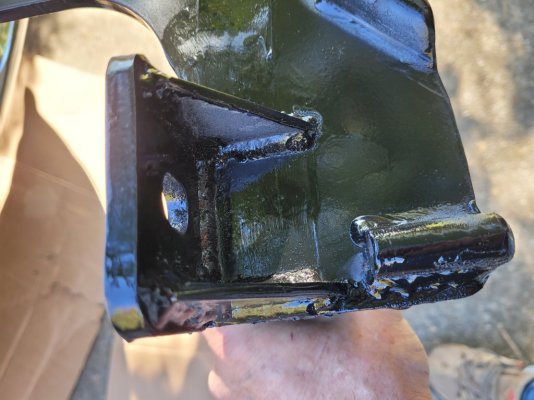

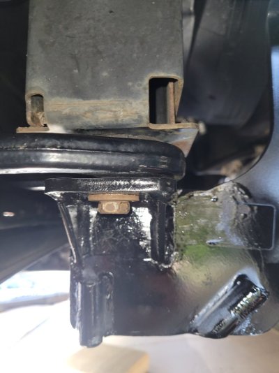

The hitch is installed by 4 bolts - the front two make use of the existing tow hook mounting and the rear get mounted to the frame. I basically just cut off the 2 front ears/flanges of the hitch and then welded them so they were level with the top of the hitch's square tube member (of course you need to maintain the same distance side to side). This dropped the ears down about an inch (can't recall the exact drop). A couple of gussets were welded on as well and also cut off those integrated loops that would have been the tow hook replacements.

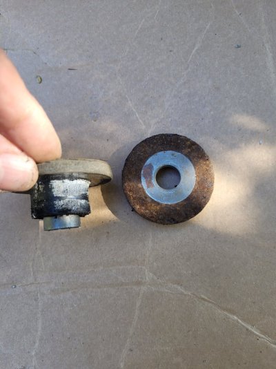

The factory tow hooks come with a flanged rubber bushing that has a removable metal inner bushing which I removed. I then cut off one of the rubber flanges.
I found a 23/32" OD, 0.508" ID, 1" long galvanized spacer to replace the longer metal bushing I removed. When the hooks are reinstalled, the rubber bushing's flanged side remains between the tow hook and frame which maintains the original spacing. The hitch is then bolted to the tow hook - the original factory bolts are more than long enough to take up the additional hitch ear thickness.

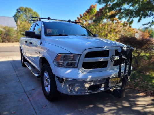

The hitch's rear bolts need to be installed per the instructions, real simple with a step drill and the hardware they supply. I did not trim the front fascia. Only thing now (of course) is the clearance is reduced. It is actually pretty easy to put on/off, the only issue the weight and awkwardness aligning it. For now I leave it off unless I have a trip planned.

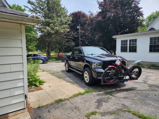

diymirage
Banned
Jan 24, 2024
1,898
2,862
Michigan
I might be missing something, but seems like a lot of work, just buy a front hitch with the hooks incorporated. that is what i did, 1 hour install, removed the OEM tow hooks, installed the aftermarket front tow hitch with tow hooks included and bolted it up using the OEM bolts and bolt holes. Like I noted with a friend helping about an hour. I think it was one 18m box end wrench was all that was needed.
what am I missing?
still got the tow hooks?

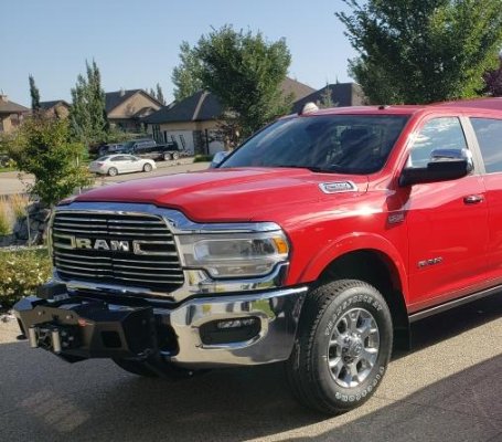

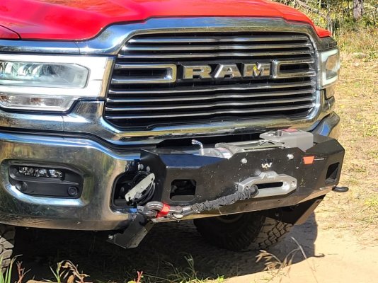

Dean2
Jun 17, 2021
4,444
8,891
Near Edmonton
2021 2500
Pretty simple really, remove tow hooks, mount front hitch, attach new tow hooks to that. Basically how my winch mount works for my Warn 16,500 pound winch.

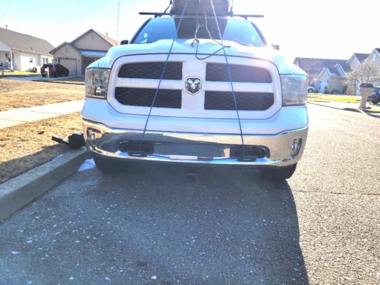

A bit late, but here are some pics:
