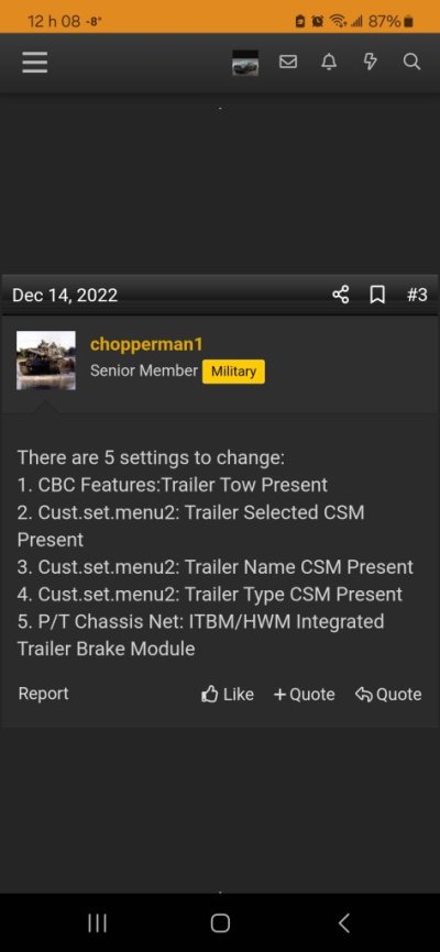

I just add the brake module 82215040AB 82215040AC on my 2023 ram classic.
Did program everything with alfa obd. I did not check if its working properly with a trailer for now. But when i pressed on the brake pedal, the evic is switching on the trailer brake gain screen to show me the % of gain, even if i'm not connected to a trailer. I supposed it's not normal ? What could it be ?!1000002269.jpg

Got it from amazon.. 82215040AB 82215040AC. So i need to return it and get the OEM ?! Can you tell me whats the right one to get ?!

Do you have anything plugged in to the trailer plug?

Nop, i just return the amazon garbage and order a OEM parts
