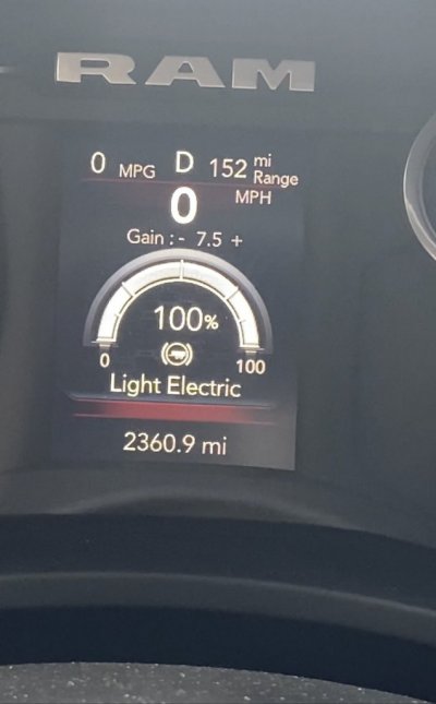

I think it’s a truck issue.

I havent hooked anything up to my new 21 yet but when I had my 2011 ram I wound up having to wire a new 7 pin connector on the trailer because there wasn't a good connection with the truck connector. Without being there and seeing and checking what's going on it's going to be hard to diagnose anything. Maybe try unplugging and inspecting the terminals
