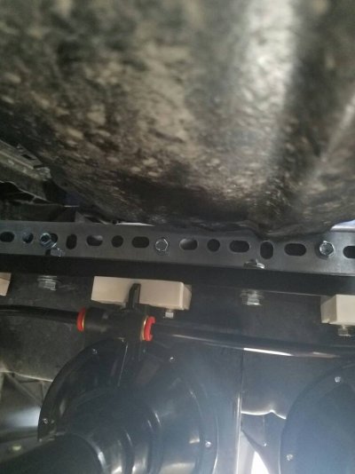

So far I've gotten this far with some heavy duty brackets and self tapping screws

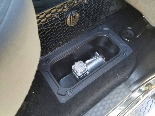

Clever compressor placement... removed the innermost lining so it will still be a whole compartment if I need later down the line.

Very clean, but, will the compressor get enough air being there?
Any chances of overheating the compressor due to it being enclosed?
jgruberman
jgruberman
Oct 17, 2015
636
149
EcoDiesel 3.0L
Having said that, I don't believe that I will need to get it much air since I don't plan on going around town honking like those YouTube morons. However in the event that I need to inflate a tire or it needs to run for longer... I can just open the floor door inside the cabin... right?

How loud will the compressor be inside the cab?
jgruberman
jgruberman
Oct 17, 2015
636
149
EcoDiesel 3.0L
I ran it all on the workbench before I installed it and it was surprisingly quiet. Also it'll be closed up in that compartment. I assume if it's running from a honk then it won't be for long and if it's running because I'm actually USING it, then I won't be in the cab anyway.

I just had a hell of a difficult time screwing it to the frame with self tapping screws so this was my Plan B.

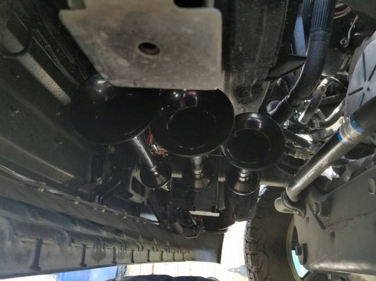

Horns mounted to the front of the frame with a corner brace
