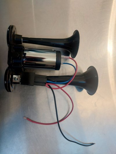

I have a 2011 truck and I have a set of those loud train horns; tested and they work, but I want to wire these so when I push the steering wheel horn pad these will go off.
It looks like the factory horn must run on a low voltage or current circuit, and it won't set them off when I have tested it. I disconnected one of the horn leads and spliced them into the factory plug but no workee. BTW the train horn only has a black and a red lead and a relay already wired in to the setup. see pic.
Any idea how to make this work?

Your best bet is to wire them to the existing horns. I "think" the horn is a CANBUS message request and not wired directly to 12 volt like they used to be. You'll wire a trigger from an existing wire at the horn to the relay of the train horn, then 12v power from the battery to the relay (and ground).

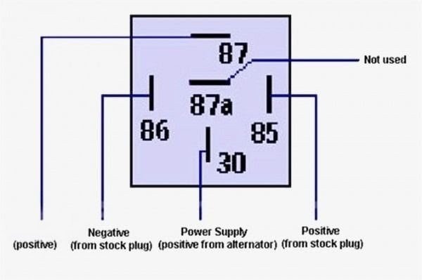

If that is a relay the horn is wired to in the picture, it not correct for isolation of the higher current demand needed by those air horns.
When I added the air horn to my truck, I used a relay with the coil wires (85, 86) directly to the factory horn. Used an inline fuse from the battery to term 30 and then 87 wires to the horn positive. Grounded the horn to the frame.4209b0c70c0a415f5650e985b8b5c5fa~2.jpg
