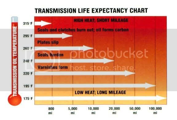

I think it has the cooler and fan, not sure though. Wat temps should I be worried about it getting up too?

ok kool, ill just turn my warning level up a bit higher on my programmer lol thanks guys, i think im gonna invest in a magtech tranny pan just to be sure
