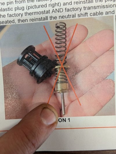

I purchased the transmission thermostat kit from Karmine/Garrett and in preparation for the install I removed the factory thermostat, per the instructions, and tossed all the factory parts.
I am now thinking I want to run Jesse's bypass and was wondering if anyone has the pin that runs through the middle of the factory thermostat laying around that I can buy.
Jesse did message me that he will send me specs to make one out of a drill bit but if someone has one laying around, that would save me a little work.

For everyone's reference, in case you find yourself in the same predicament as I did, here's what Jesse said:
"Get yourself a 7/64" (.109) drill bit and cut it down to an overall length of 1.200". You'll want to keep the ends rounded off fairly evenly. It can still have the spiral of the drill, that won't hurt anything."
