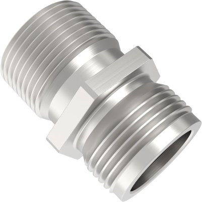

Unless your trans is over heating when towing why are you installing the ATS bypass, being I see your in NE you will want it come winter to help heat up the trans faster? As for the trans not engaging right away it could be, torque convert is draining, bands out of adjustment or heavily wore, the spin on filter inside has fallen off or is lose, the plastic adapter that come with the filter should be replaced, many like my self buy an use metal adapters like the one pictured below to prevent the filter from falling off or coming lose.
