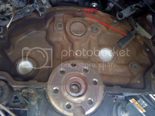

It is behind the passenger head in the tranny bellhousing and you are working blind.
Also this should be a Mopar part only! Do not get aftermarket CKPS many have had issues with them.
Edit to add pix
On the right side of the motor, see the part with the wire going to it= CKPS
