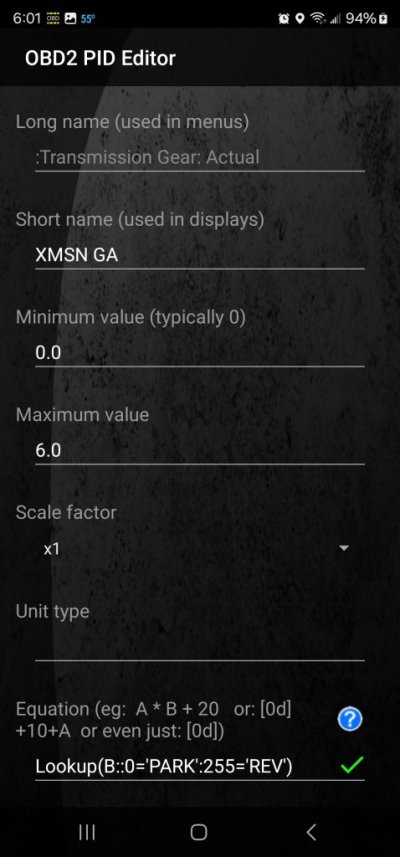

for some others that I got PM;d the actual dear for the 6 speed
the lookup formula will put in the wording instead of numbers

should not be CTD only, try the the google file download and get then all.
here is the bottom part of the Idle and the same for the run hrs
