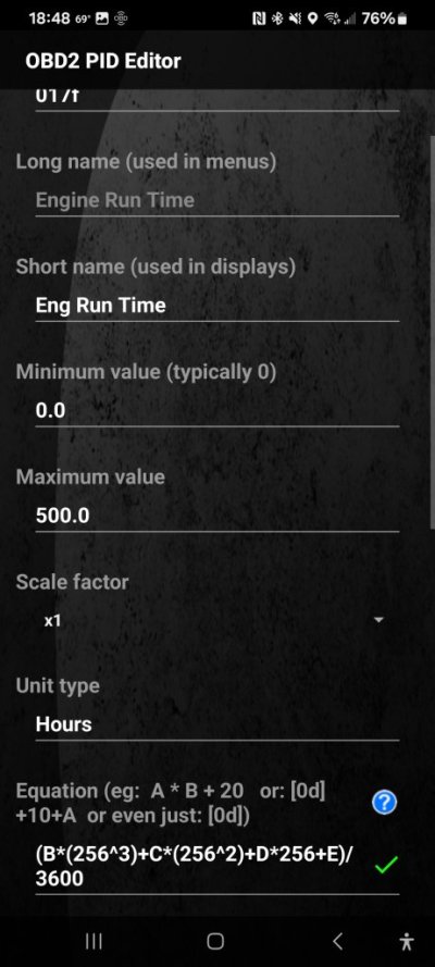

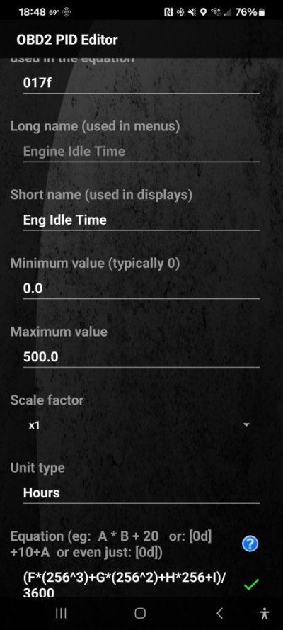

First thing, I am not affiliated with the Torque Pro ap or the Google drive information. I have been running both for since the first month I got the truck back in 2018

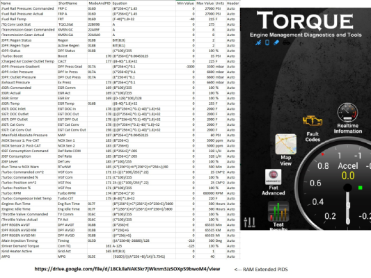

As alot of others, my EVIC engine run & idle hours display loves to jump around. I found through the Torque Pro(TP) ($4.95) ap that you get these free extended PIDs and you can get the true readings at this google drive area. Download them as a .csv file and you can add them to the PRO version. https://drive.google.com/file/d/18CkJlaNAK3kr7jWknm3JzSOXp59bwoM4/view
Sorry about the cheesy screen shots
In the first 2 columns are the the settings when looking at them using the "edit PID" screen
Top of the last column is what is displayed on the screen when they are chosen,
Bottom of the last column is the name in the options list when choosing them

So how exactly do I do this? I created custom pids for eng run and idle. Now what? Not real familiar with torque pro app

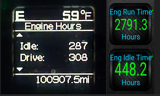

Just out of curiosity, how does that compare to the idle and run time numbers in the cluster?

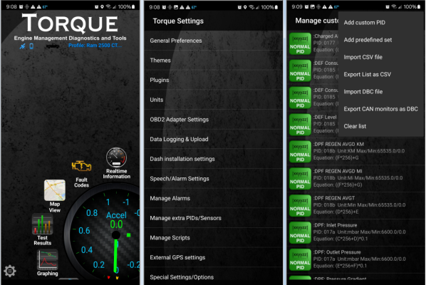

go to main "splash" scree and hit the gear(bl), "Manage extra PIDs/Sensors" 3 dots(tr), "add custom PID" or "import CSV file"

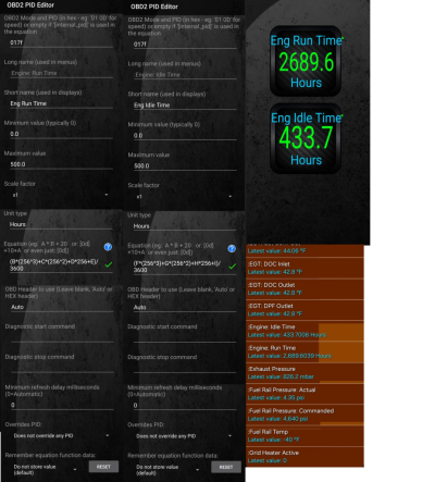

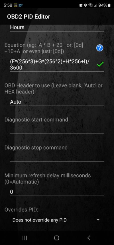

IDK what I could be doing wrong, but added the custom Pids and added a display to be able to view them,but says no data. I rechecked all the information entered and it looks 100% correct. 1000002166.jpg1000002165.jpg

This isn't a diesel specific is it?
should not be CTD only, try the the google file download and get then all.
here is the bottom part of the Idle and the same for the run hrs
