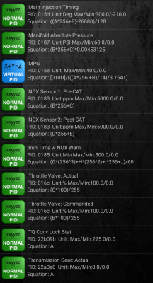

Got really bored at work and looked around for the REGEN and DEF stuff that I can peek at. So decided to splurge and get the $5 Torque Pro to go with the OBDLink MX. I have the security bypass cable in, but did not test if any different than without. Here are the settings that were active for the "extra" stuff.
Installing the app and the PID file into Torque.
1. Download the Torque Pro from the play store and run Torque Pro.
2. Download this csv ile https://drive.google.com/file/d/18CkJlaNAK3kr7jWknm3JzSOXp59bwoM4/view
3. Move the PID definition file to your phones INTERNAL storage's /.torque/extendedPID folder. (you may have to turn on hidden/system)
4) In Torque Pro: go to Settings, Manage extra PIDS/Sensors, Add predefined set, Choose 2013+ 6_7 Cummins PIDS
source: https://mopar1973man.com/cummins/ar...que-pro-for-gauges-extended-pid-sensors-r577/

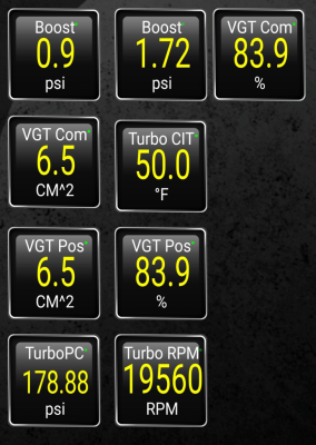

Turbo (have to compare #1 & #2 driving):
Turbo Boost VERIFIED: *****, don't know what it is reading
Turbo Boost & Vacuum Gauge VERIFIED: Works as same as dash reading
Turbo Commanded % (VGT)
Turbo Commanded cm^2
Turbo Compressor inlet Temperature
Turbo Position cm^2 (VGT)
Turbo Position % (VGT)
Turbo Pressure Control
Turbo RPM

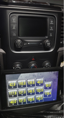

I am using a Samsung TabA 10.5 (S20Ultra also). I just pull the tray out and lean it there.

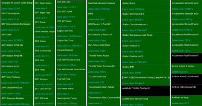

I noticed that with the tablet connected and act like I am adding a display, the sensors (PIDs) that work are bright green. There are some ones that I get strange reading when digital is chosen. Like the Torque converter, it reads 32/64/128. I would think that it is either locked or unlocked and appears to be 3 conditions.
Black-Not supported
Bright Green-Supported
Dark Green-Calculated by vehicle profile (user inputs)

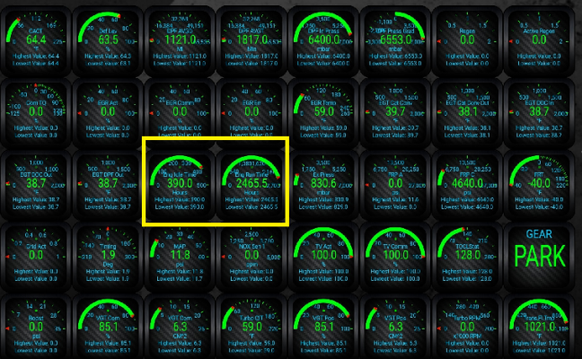

There is a known issue where the engine hours reset themselves.
But it looks like Torque Pro to the rescue.
The display showed < 1000 hrs and 0 idle hrs
