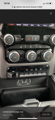

Right, the switches I wanted or am familiar with is the Uplifter from the Ford set up which was on my raptor the only information I found for PW was the link I posted and the option I don’t have. It’s called Upfitter ElectronicModule (VSIM)
No one seems to know anything about this or has a 19 that has done it. I don’t suppose you know and are withholding information?
This is a please help me thread and not a how to(not yet at least) I already picked up two sets of rigid lights and vision X. Gearing up and was hoping to stay stock looking but this is not my first rodeo mr smart. Plan B is switch pros. Though Rough Country had some switches and relay setup that did not fail me in my last rig. But thanks for checking in.

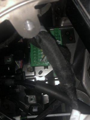

There is a few guys that bought the 2nd row of switches just below the heated steering wheel switch on the 17&18 and was successful. (Added a pic) The only visible switch I can see I’m missing, is the engine brake (use for the diesel model)
The option, from what I can tell has been available for 4 years and is an option for the 2020 PW. I’m not sure why any one that orders their PW would not opt for only $375

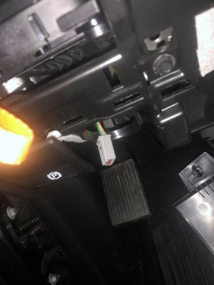

I read that all wiring is available and in place rather you have the package or not. Like in my first pics you can see the ram box plug just behind Panel yet I don’t have ram boxes. it could be a dead end but I see slots available (added a pic) my truck has everything but the ram boxes, so that’s why I think those spaces is what I should be plugging into.

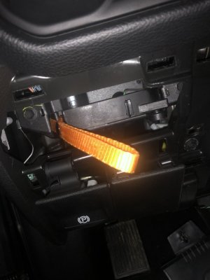

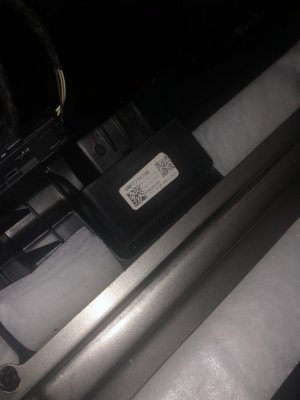

I’m going to run switches for lights and was hoping to tap into the truck wiring and harness. Seems that I’m missing the Module under the steering any 19s get that option on their truck? on the 18s it’s under the radio. I have added a few pictures of it helps. This might be a dead end and I will have to install relays and do some setup like https://www.switchpros.com/
