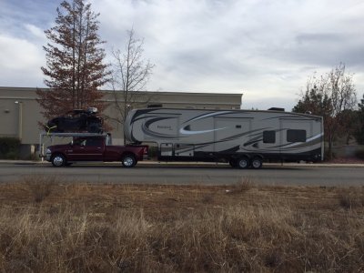

718193A4-7ED2-453A-B627-0CA611C20CBC.jpeg I definitely use my truck hard. I weigh almost 29k pounds going down the road.
