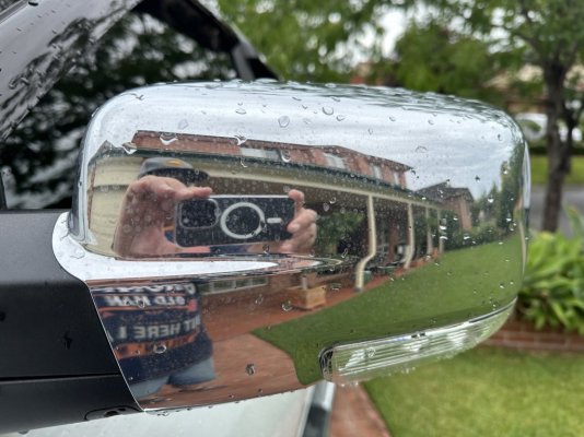

I have a 2018 RAM 2500 Laramie and I am in Australia, the Dealer said that they don't comply to Australian Design Rules.
But then I see the Later model Rams and same mirrors and the Turn Signal with the door mirrors are flashing, I have a AUTEL Mk808 TS can I turn the signals on with this unit. Just asking as I have the SGW Module which is located inside the Dash and I don't want to pull it apart without knowing if I can or not. The Paddle lights work fine, just no turn signals.

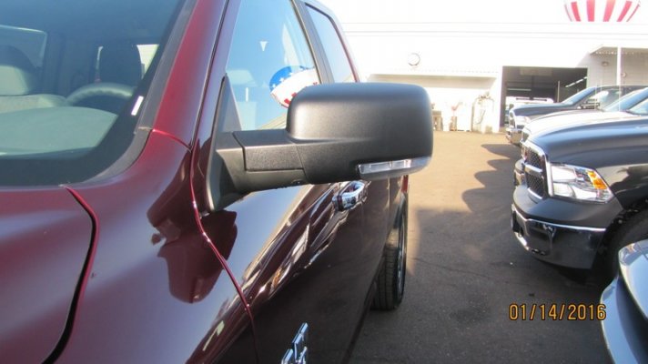

I don't have the mirrors as shown in the Link, my mirrors are chrome 1DA189DA-DA17-4CF7-A96F-5E3FB78C3F4A.jpeg

The chrome is just a cover, i have a 2016 just like it, except the cover is dull Black

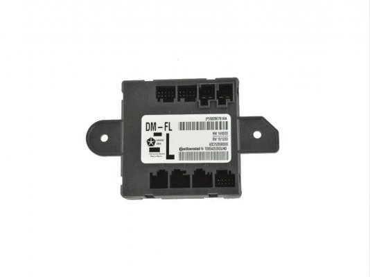

I know that some features/functions of the mirror need a certain door module
Like if a brand new Ram does not come with Power Folding Mirrors, it would come with a basic door module
Just buying a set of mirrors with the power folding function, would also need a Door Module & programming to make it work
So you either need to check your door module to see if your module controls the signal lights.
If it does not, maybe someone builds a bypass of some kind

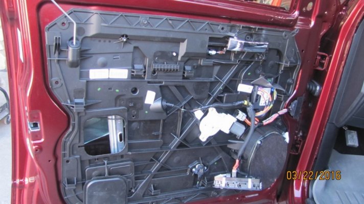

the door module is directly above the speaker
it will have 8 slots to plug things into
my mirror is not mounted in this image
the mirror has 2 male plugs that would be plugged into it
Front Left drivers door module

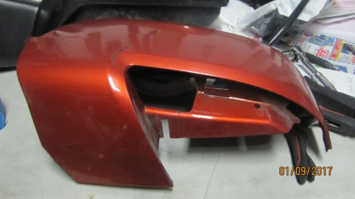

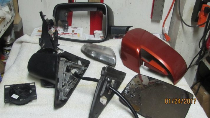

I took apart a mirror after it had been damaged, this is the outside shell

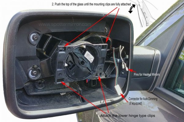

Hi There,
Have you a photo of you Mirror Housing mounting to the holders, I have bought some new Chrome units and need to remove the mirror glass, haven't seen and removed from power mirrors.

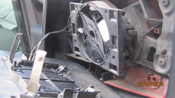

I suggest that you read up on a tool called AlfaOBD app, so you can modify your settings
Your door mirror glass may be different than mine, as yours are on a 2018 Ram.
With Mine, the mirror glass should be tilted down & maybe in towards the cab
This allows you to look in behind the mirror glass.
If it looks like this behind the glass
put on some gloves for safety
Then place your index & middle fingers behind the top of the glass & place both thumbs on the face of the glass.
Now give a tug on the back of the glass, pulling towards your chin & chest, you are trying to release the 2 top clips, so it may take a little more of a tug to release the clips.
The mirror glass will be held on by the lower 2 clips. you will need to tilt the glass at about a 45 degree angle & lift while jiggling the glass.
Now you can disconnect the wires on the back of the mirror glass
If you look below the mirror motor, you should notice a black clip
That clip is a release for the signal ight within the mirror.
With very basic tools, you can completely disassemble these mirrors
