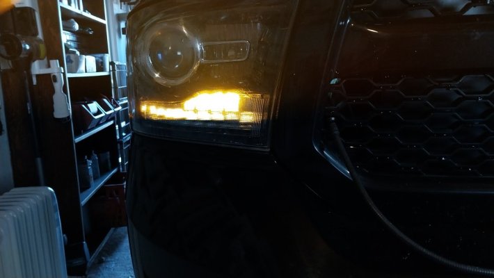

Hey folks, so I've been getting the hyperflashing issue inside the cab of my '17 1500 but all the signals seems fine. Or at least, I thought. But I finally noticed that the right turn signal has a "square" out. I figured just change the bulb, right? Nope. There is some sort of board with integrate LEDs on it and I'm guessing that the entire headlight assembly has to be replaced because of one silly LED out on the board. Please correct me if I'm wrong. I cleaned the connector, both ends, with electronic cleaner but no joy.
Can the board itself be replaced? I was worried about breaking tabs to check it out, and I can't seem to find a replacement board anyway.
I should mention that they appear to be OEM "RAM" headlights with a single connector and two bulbs, one for the regular beams and one for the high beams.
I found a replacement assembly on eBay but it says it's for a 2013-2015 RAM, but looks exactly the same.
eBay Assembly
Thoughts and suggestions? The super-fast flashing in the cab is driving me bonkers, even though the signals on the exterior flash normally. I thought about trying to live with it but what happens when a bulb actually does go out?
Many thanks!

Looks like a reasonable replacement and at that price, it's not a big gamble. Good luck.
