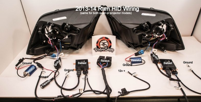

Here's the pics of the wiring differences
Full harness:
Canbus adapters:
yours will need the full harness if you want the full use of your highs (and the diode)

I think the canbus will be fine. So your saying I would only need the full harness and the diode if I want my highs and lows on at the same time correct?
If i am right then i don't need the highs and lows on at the same time so the canbus will work.

bingo!
