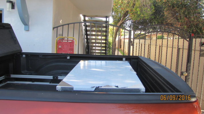

Say that you want the tool box to be 24" deep by 65" wide by 17" tall.
That is doable, but as you see in this image, the inner fenders are in the way !
i know, the image is of the type that sits on the rails, not the Flush Mount. but it shows that the inner fenders are in the way. the tool box won't sit where it belongs.
What has to be done, is to measure the part of the inner fender is in the way, what needs to be done ..
The corner of the box where the inner fender will not let it sit down, has to be cut out, cut it with a little extra clearance.
Cut both bottom corners to match, now the interesting part.
You have 2 sides & the bottom of your toolbox, the other corner is exactly the same.
Switch the right corner with the left corner & visa versa.
Now, turn either piece over & fit it to the corner, so what was the outside bottom of the box is now inside the box facing upwards & you now have a nicely notched box that fits over the inner fender wells with a bit of clearance.
I think i wrote it correctly.
