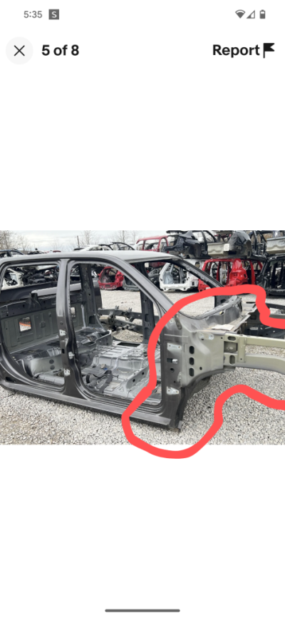

Hi everyone, had an accident last weekend in my 2021 ram 1500 warlock. I rebuilt my 05 Dodge ram way back when it was in an accident. This one is a little more extensive than that one. I was wondering what all years I can use for my body panels. I see a lot of parts for 2014-2017 body panels wise and on big horns more than warlocks. Are they compatible for what I'm looking for like exterior pillars and fender brackets? The skins are easy to find but the internal brackets not so much. Just trying to figure the years out so it's easier to get what I need. For my 2021 to get it back on the road. Thanks in advance
This is sorta what I'm looking for in specific part.

Your Warlock is a 4th gen 1500. So you should theoretically be able to use body parts from 2009 to current 1500 Classic. Although I'd probably avoid the pre-facelift model years (2009 - 2012) just to be safe. And you might also want to avoid Rebels for certain front end pars.

Awesome I really appreciate any advice on this project. I found a few part outs locally to me for 2014-2017s so I was really hoping I could use the internal frame bars for some of it. Thank you again so much
