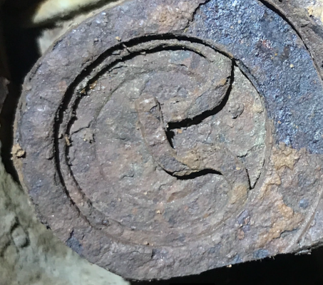

Find this model is match the size: 5-153X Universal Joint, which size is 1.062" Cap Diameter, 3.219" the caps distance(long, width), it's really close my 27mmx82mm, the question is the lock ring is two type, the original U-Joint is like following:
The Front U-Joint:

The front drive shaft is designed one time use, difficult to remove the u-joint and also difficult to fix the new one, one pair is no locking ring, directly lock by the metal body deformation, like the first photo
