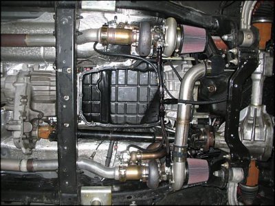

on another forum. twin turbo rt
It has been a long winter, but my latest project is complete. Here is the run down and some pics.
All Stainless Steel Construction
Twin 72mm Garrett T3/T4 Turbos
Twin 38mm Tial Wastegates
50mm Tial Blow Off Valve
Air to Water Intercooler
Turbosmart Boost Controller
Belly Pan
I am currently running a safe tune at 8psi and making 471 HP and 498 TQ at the wheels.
Belly Pan

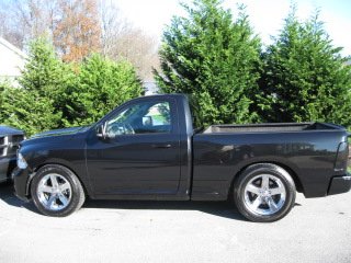

On a ram?
xxxotiknightz
Nov 10, 2010
621
28
Salt Lake City UT,
road and track i believe. Im sure someone will correct me if im wrong.
Isnt a badge all the r/t package is anyway?
Road and track is correct. And nope
^ haha! Think it comes with 4.10 gears, and lighter 22" wheels too.
Man, why a Single Cab? He should have done that to a bigger truck! Like a crew cab! MUHAHAHA!
R/T comes with 22" wheels(if 2011) 2009-2010 came with 20" wheels, 4.10 gears, better torque converter, R/T badge, challenger like hood. It only comes in regular cab 4x2
