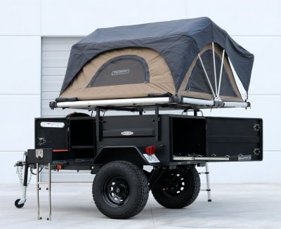

I plan to just bite the bullet an buy a Smittybilt Scout pop-up trailer.
