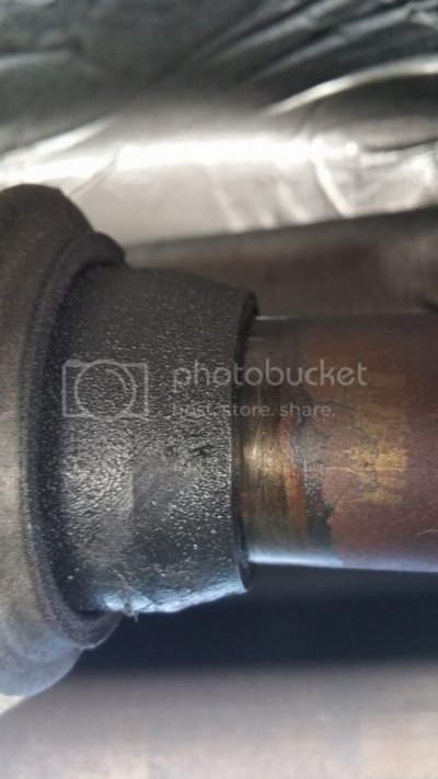

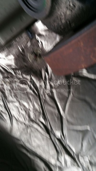

Hey guys having a problem with my 2010 dodge ram hemi cc. Driving around 45-55mph and lightly accelerating I here a light finding noise. Tried to dismiss it as mds but I don't think it is. Crawled under the truck and but the tail shaft of the trans I see some grease all around it and looks like it splattered on the bottom of my truck. Praying it's not something serious. Any ideas on what it could be? And about a week ago I found some b b's where I parked my truck dismissed as maybe kids next door but now am thinking it could've been of my truck. Any help is appreciated. I'm worried cause I still have to drive it to work want to make sure it's okay.
Last pic is hard to see but you can see where it splattered up.

Just the output shaft seal leaking on your transmission. Easy and very quick fix. Doubt this would make any kind of noise.

It doesn't look bad to me. Your drive shaft has to slide in and out of the transmission as your suspension cycles up and down grease isn't the end of the world if you start getting some red transmission fluid coming out that's when I would suggest changeing the rear output shaft deal.

The rear tranny seal is cake.. u said u saw bbs.. and that oil splatter is right above the u joint.. when u joints go bad... most commonly they make a "clicking sound" and it can sound like it is coming right out of the drive shaft.. it's amazing how well the sound carries down it. if u do the rear seal.. go ahead and swap that u joint as well.
