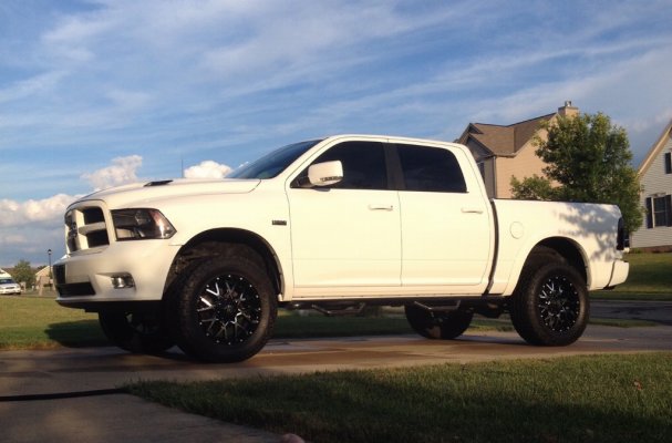

I have same gears, and the Hemi on 35's, and every day I kick myself in the ass for not getting the 3.92's when I ordered ... Any way, I've been very happy with my Zone 4"F/3"R with Bils set at 1.4 ... Fits in my 7' garage door, and most parking decks ... With the 5" drop hitch I've pulled a number of different trailers with no problemse6c3c2950695af9a81f889c8f9de5024.jpg
