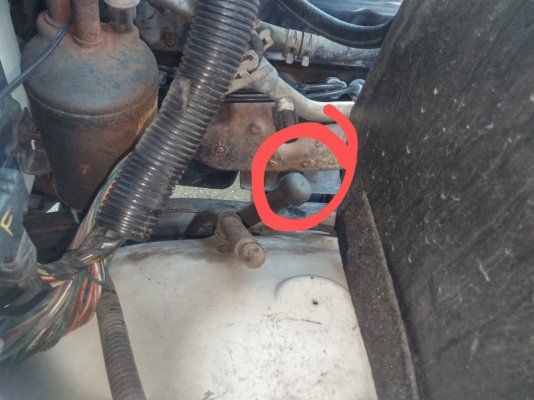

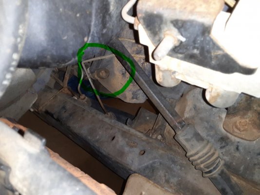

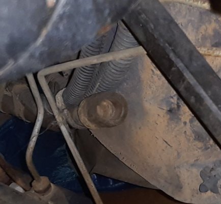

Nearing the end with this gremlin infested 97 Laramie SLT 5.9L gas. Can someone please post a good picture of your engine bay focused on the firewall underneath the brake booster, under the steering rod? Replacing purge valve and canister because lines are full of charcoal. Lines are cleared now, but large line that exits canister routes to the front underneath the brake booster (SEE PICTURES).
Or, can someone please tell me where the missing line is suppose to go from here to where? This is an approximately 5/8" line with a rubber coupling on the end. I cannot find an open port anywhere, much less 5/8". The breather, intake manifold, nor the brake booster have any open ports. Can someone please tell me where this is suppose to connect?
Even the EVAP diagram on this truck is confusing to me. It clearly shows one line going to the tank, and a second going to the purge valve, but no third line. My canister has THREE lines. As you can see from this pic, the one goes to the tank tees with the one that goes to the purge valve, and the larger one comes out under the steering rod.
