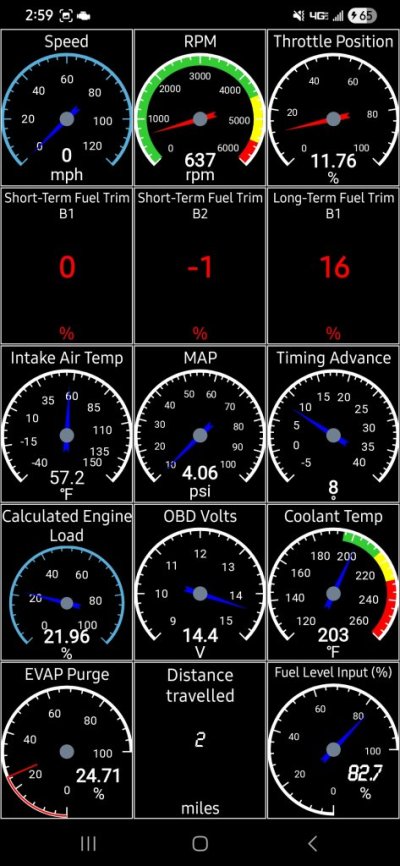

What's happening is the ECU is constantly correcting fuel ratio for an extremely lean condition, and it's dumping fuel into the intake especially at idle. It seems to me a vacuum Ieak would be overly effective at idle in producing these symptoms.
O2 sensors are working fine.
Short Term Fuel Trims are somewhat normal, they swing between -5 and 5 while regular driving but Long Term Fuel Trim is up at 18 or 20 at idle. When driving or holding RPM at 2000 it will go down to 5 - 8.
As a note, after the fill and first drive, that purge valve opens right up and stays pretty solid at 50% to 75% and that makes me feel like between that valve opening so hard and for so long coupled with the ECU thinking it needs more gas immediately is literally causing the engine to stall at idle, especially if there's a vacuum leak and unmetered air is entering the system triggering the "lean" condition the ECU sees.

The 2 pics are random while driving. One is at idle. Note the Long Term Fuel Trim at idle, showing how the ECU is still over correcting a false "lean" condition and killing my MPG.

Disconnect and block off the purge valve. Repeat the testing. If fuel trims return to normal, you have isolated that the engine corrections are not the problem, that the EVAP system needs attention.

Now onto your fuel trims issue. I can think of the following things that will cause exactly what you describe (lean at idle good enroute)
1. Intake manifold gasket leak. Sucking air in - Between the bottom of the manifold and the head. (Replace intake to heads manifold gaskets)
2. Cracked intake manifold (replace the intake manifold)
3. Vacuum hose leak (replace or repair hose/fittings)
… all of the above to check for and easily diagnose using a smoke machine.
4. EGR sluggish and/or sticking partially or fully open. Replace the EGR or block it off. The EGR can and often does go bad without throwing a CEL. No code does not mean the valve is not failing.
I sincerely doubt the evap system has anything to do with your symptoms - other than slugging and stalling after a fillup when you’ve overfilled as noted.
